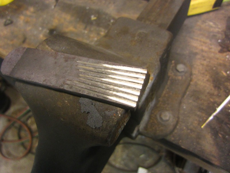

I've started working on the tailpiece again. My old 4" angle grinder broke, so I had to get a new one.
First the wheel is shaped so that it will make a round groove, then grooves are cut on both sides of the billet, offset from one side to the other.
Before grinding:
After:
To be continued...

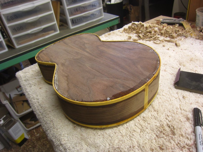

Well, the binding is all glued on now. I'm not real happy with the fit of the top bindings though. Before I do another archtop, I need to build a binding router jig thing...
I painted the channels with shellac first:
The bindings. They came out of the bender a little lumpy in some spots, so I had to touch them up on the iron:
I also worked on the fingerboard a little. I tapered it and added side position markers:
I'll finish forging the tailpiece tomorrow, and will probably be able to string it up, "in the white", shortly thereafter.

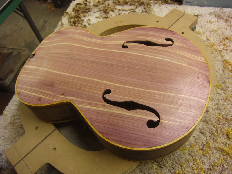

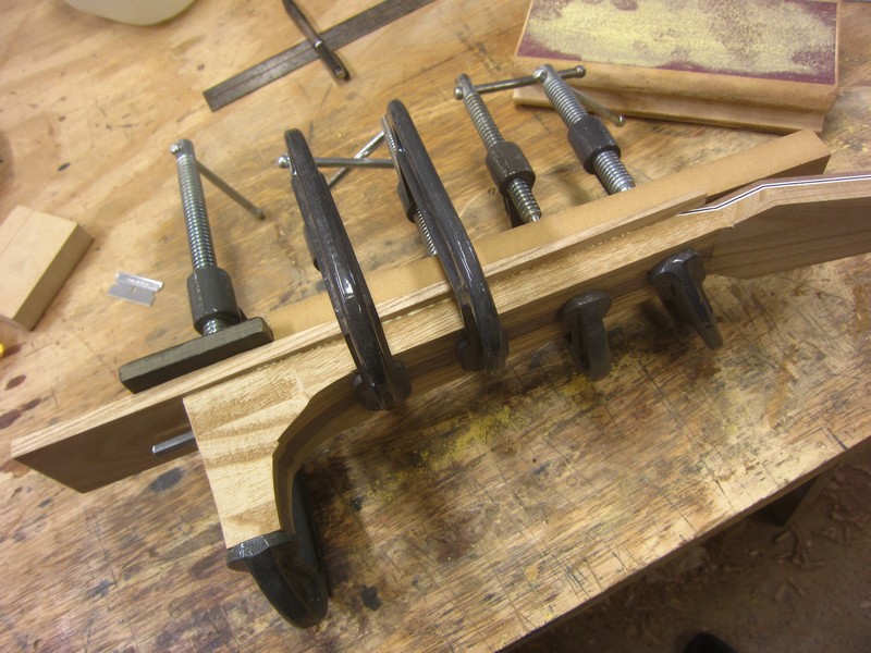

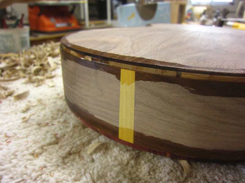

I actually haven't done anything on this project since last weekend, but here's some more pics from then.
The binding scraped on the top and back. Have to do the sides yet:
The inserts, inserted:
The neck joint flossed:
The wedge glued to the neck:
The fingerboard radiused:

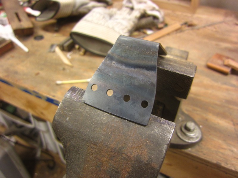

The tailpiece. Sorry, I missed some intermediate steps. Basically, I drilled the holes, then used a torch to soften the area I wanted it to bend, and bent it. I think I may be scrapping this one because it's not wide enough. We'll see.
I used a small cut off wheel in my Foredom and needle files to make the string slots.

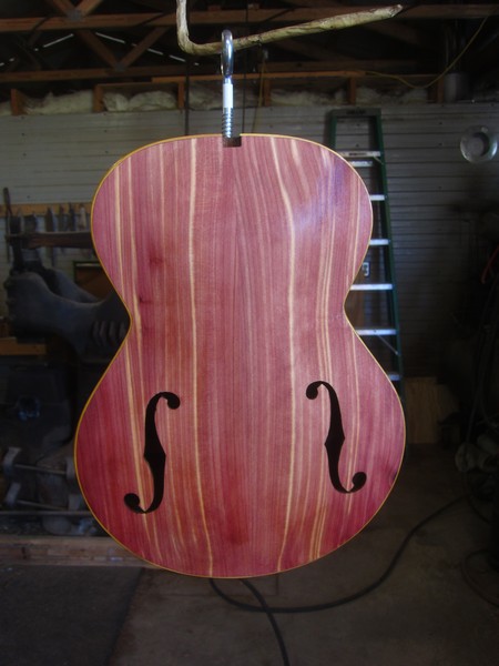

It's coming along pretty well. I hadn't really done anything on it for a couple months, then realized the deadline is quickly approaching, and I'd better get moving. duh So, a few weeks ago I shaped the neck, and this week finished sanding and started spraying.
I did have it strung up in the white, and it sounded pretty good. I think the eastern red cedar is fine as a top wood, but you won't see it used much, since it's so hard to find pieces big enough without knots.

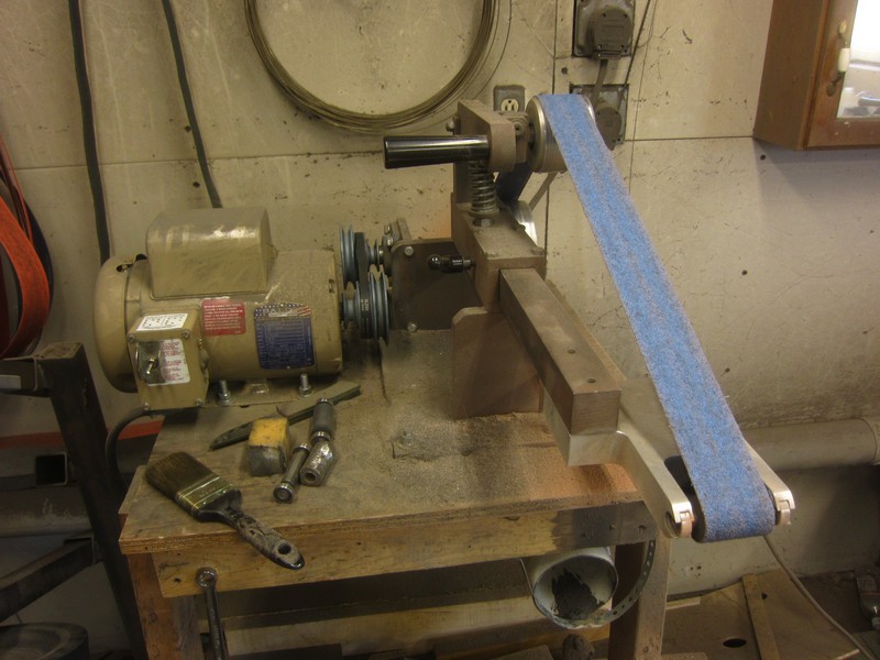

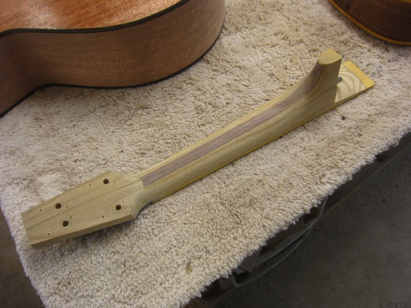

Ok, here's the first round of the semi-final pics:

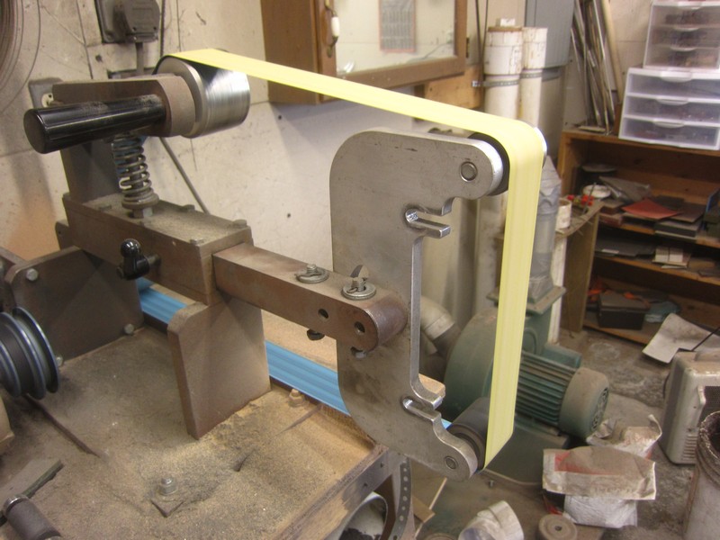

The neck before shaping:
I use a belt grinder called the KMG (knife makers grinder) from Beaumont Metal Works. A wonderful tool. I'd be lost without it.
Here it's set up with the small wheel attachment:
After shaping the way I want, I use a different attachment, with a slack 240 grit belt to remove the 40 grit scratches:
All smoothed out:
I'm finishing this neck with Tru-oil. Here it is with one coat on:

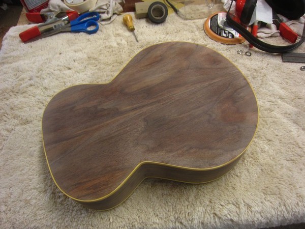

I decided I didn't like the color of the top, so I'm painting it gray:
Just kidding! I'm actually using the paint to help me find any imperfections on the top:
I'm not pore filling this instrument. I'm doing a quick and dirty finish. First, a couple coats of shellac, then sand it smooth:
Regards,

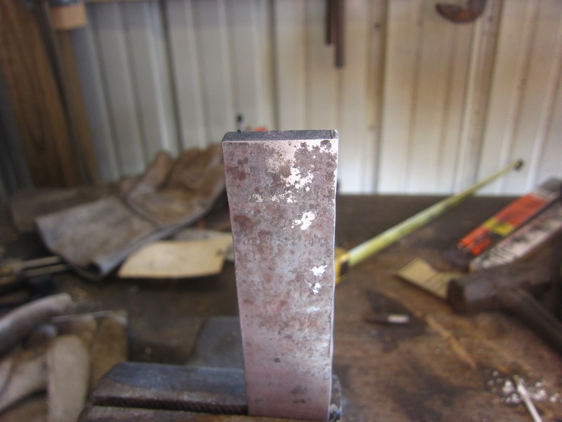

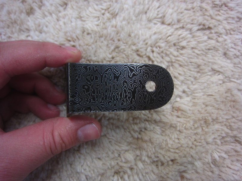

Now, the tailpiece.
I heat treated it because hardened and tempered damascus gives much better contrast than soft (annealed).
Before etching:
After etching:
After buffing:
I repeated the etching/buff process a couple more times, etched it one last time, and left it in the neutralizing bath for several weeks. Then I lightly sanded it with very fine paper to bring a shine to the bright layers, while leaving the others dark. Then I sprayed several coats of lacquer to keep prevent rust. As soon as I find the tailpiece, I'll take some pics of it...

More pics:
Now I just have to find someone who can play something I can record and post...
